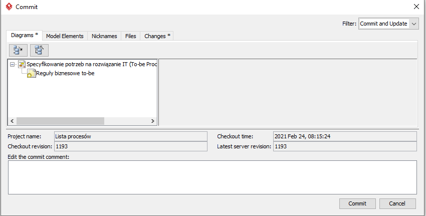

Thank you for your post. Do you have any ideas what are the changes left to commit in the second round? Could you post some screenshots of the Commit window? Thank you.

Yes, the functionality “diagram patched” could be the source of this issue. What’s the reason that after commit VP is changing something by him self? and how to disable this?
