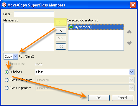

b. The same goes for inheritance from abstract classes or just classes.
Ans: Yes. Here are the steps (please see attahced image):
i. Right-click on the superclass
ii. Select Move | Copy Members… from the popup menu. This shows the Move/Copy Class Members dialog box.
iii. Select the operation and move to the selected item list.
iv. Press on the Copy drop down menu, select whether to Move or to Copy the operations to the subclass.
v. Choose the subclass for copying/moving the operations to.
