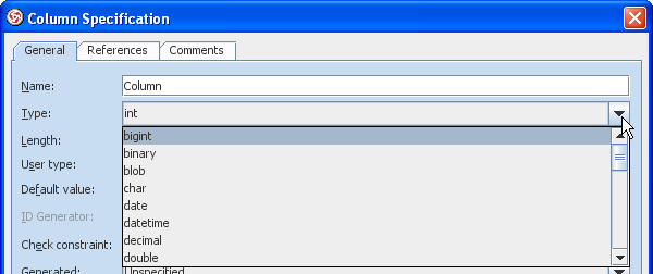

Hi Arnaud,
Thanks for the clarification. Please configure MySQL as default database at Tools > Object-Relational Mapping > Database Configuration first, then you can see data types for MySQL exists in the drop-down menu of type field in column specification dialog (as shown as the attached image).
For other data type, e.g. enum, set, you can define in the User Type field in the column specification dialog. For more details, please refer to:
http://oldresources.visual-paradigm.com/vpsuite2.3sp1/user_type.html
