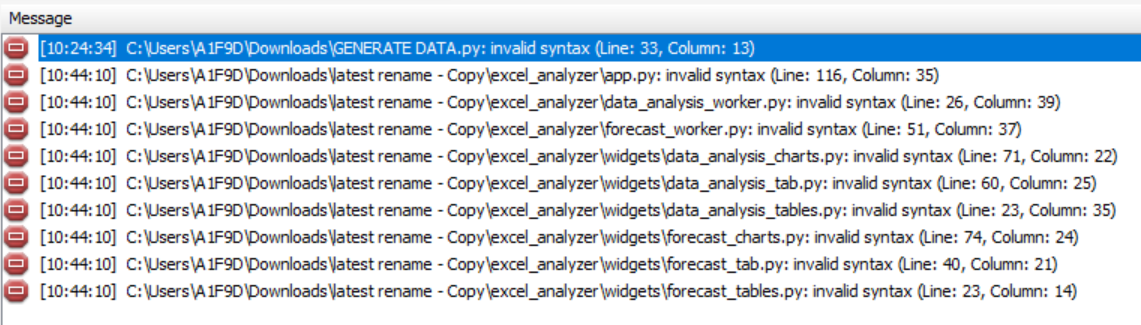

Case 1, My Full Project I am trying to reverse
Files Link: https://drive.google.com/uc?export=download&id=1sDkVEok1npn7F_VaBpjF5zFqgZBI2CEB
Error Messages:

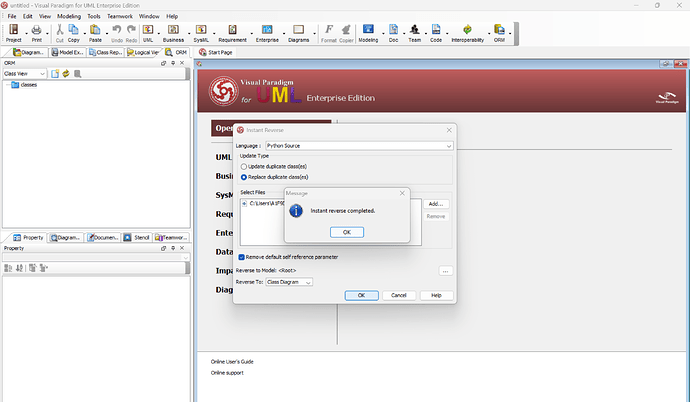

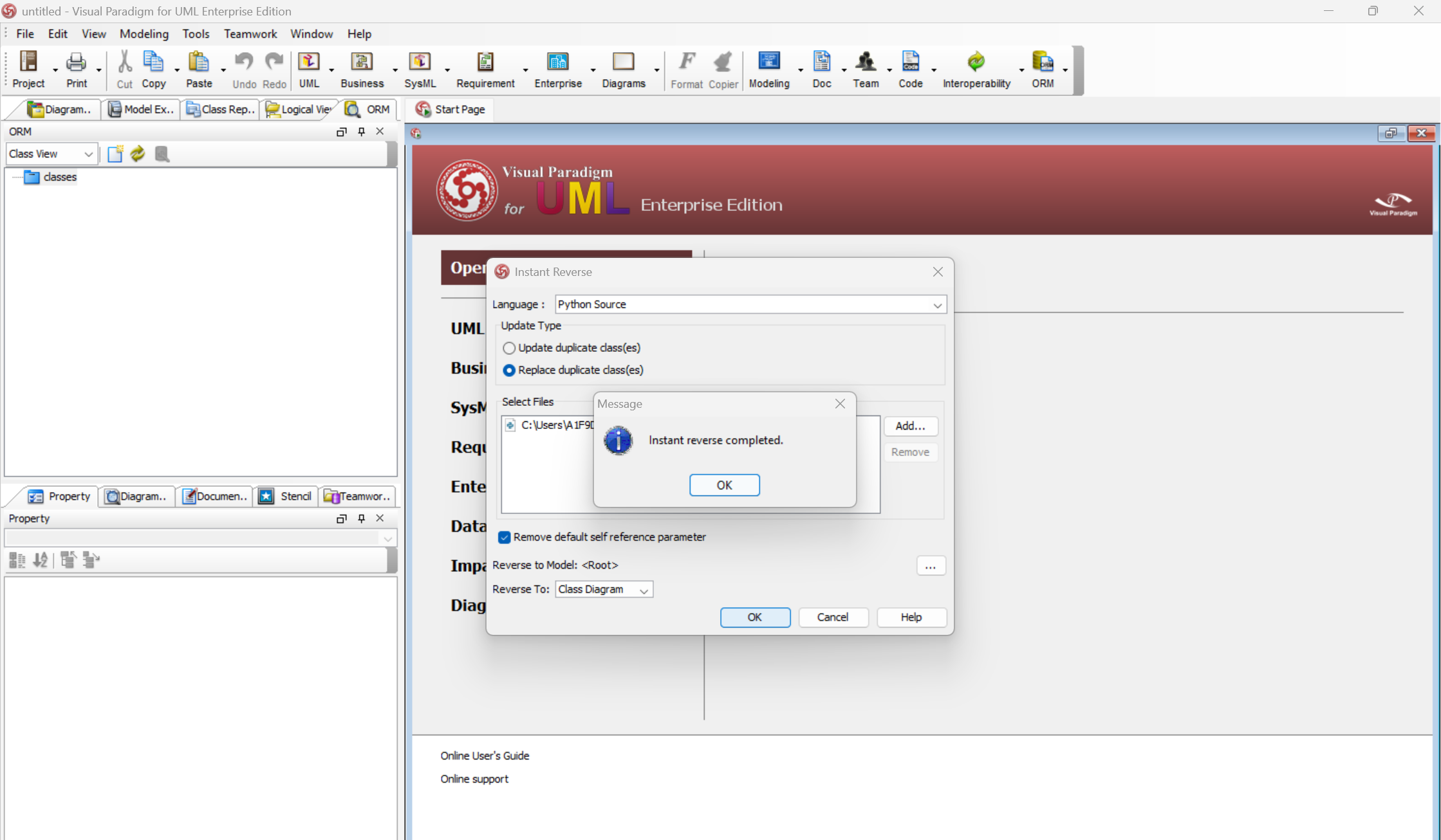

Case 2, A Simple “Hello World” I am trying to reverse
Files Link: Google Drive - Virus scan warning
Success Message but Diagram Not Found Anywhere:
Video Recording of What Happened: https://drive.google.com/uc?export=download&id=15xfiETvjKJi3kJcsGwaa23xqRB-9FSYZ

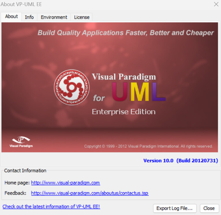

This is my version information:

According to your screenshot you are using the very very old v10.0 (which is no longer support or maintain, and should put into museum…). We tested the latest patch build (20250630bq) of version 17.2 and confirm it can reverse your python source sample. If your license covered from maintenance contract then I strongly recommend you upgrade to latest v17.2, and then upgrade to our patch build (https://www.visual-paradigm.com/support/articles/update-to-latest-patch.jsp) to solve your problem.
If you unsure about your license status then you can send us your license info to support@visual-paradigm.com so that we can help you on it. Feel free to contact me for any questions and wish you have a good day!
