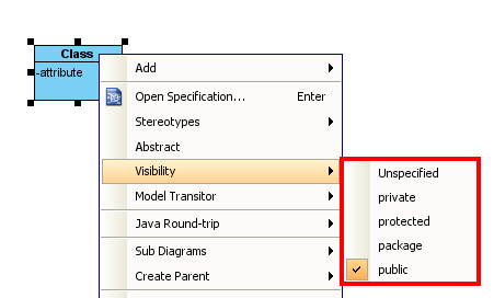

  1. You can right-click on the class/attribute, select Visibility > public in the popup menu (you can refer to the image attached), then it will change to be public in stead of private.

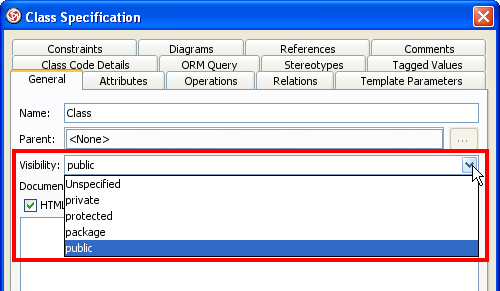

  2. You can also change in the class/attribute specification (you can refer to the image attached).
