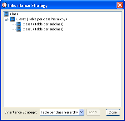

I have follow class diagram (please see classes.jpg). Can I get the follow ERD (ERD.jpg)? What kind of inheritance strategy I must select for each class?

Hi Eugeny,
Thanks for your inquiry. Please refer to the attached image for how to configure the inheritance strategy on the super-class “Class”. Hope this helps.

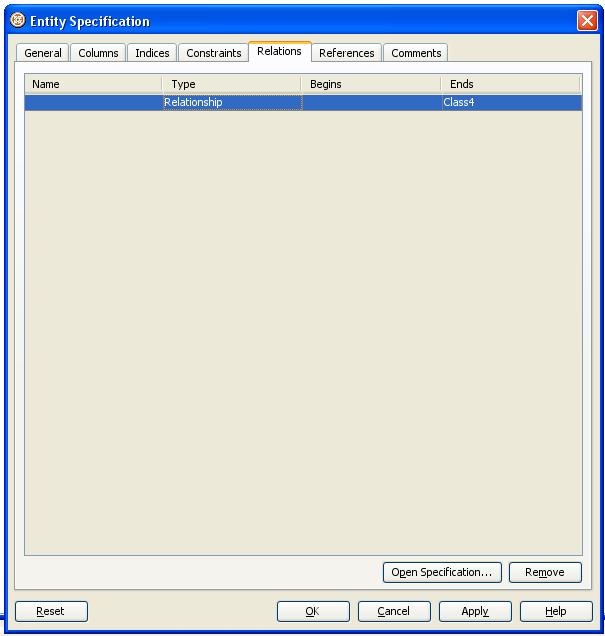

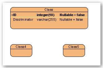

But in this case Class4 lose own parent in Relations (please see attachment). Why?
In this case, there are three classes without relations:
It’s work, but I don’t understand why…

Oh, I’m sorry. It’s working then “Top Base Class” table per subclass FK mapping is selected. But in case of select “Super Class” it isn’t work…
