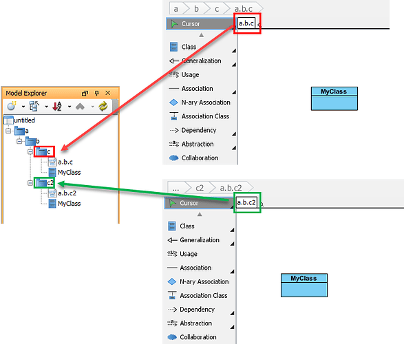

Hi Jurek,
Thank you for your inquiry. A possible solution is to make use of the package header feature to store the classes created in a diagram to a given package. The image below shows how it works. By entering a different package name on top of the class diagrams, the classes created will be kept under the two packages accordingly.
Hope this helps. Feel free to let us know if you have any other questions.
