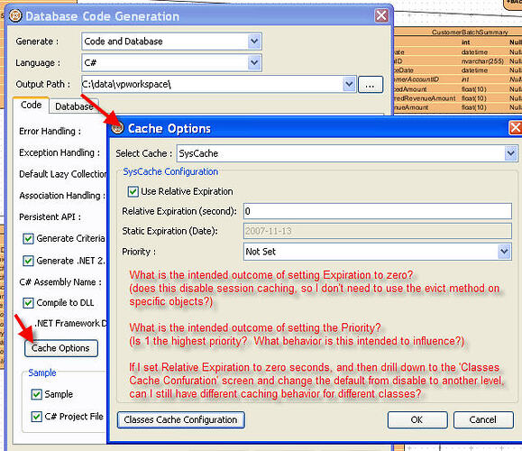

Code generation Cache Options - what behavior should I expect?
I’ve reviewed the forums and the closest item I can find to my issue is in the following URL related to Forcing Objects to reload.
http://forums.visual-paradigm.com/posts/list/995.html
Besides the evict method, I’m curious to know more about the intended outcome of selecting different Cache options on code generation.
I’m using VP DBA for .NET, generating C# code off an ERD.
In the product documentation the screen for setting Cache Options is not included. (screenshot attached)
Any information to help answer these questions would be much appreciated:
What is the intended outcome of setting Expiration to zero?
(does this disable session caching, so I don’t need to use the evict method on specific objects?)
What is the intended outcome of setting the Priority?
(Is 1 the highest priority? What behavior is this intended to influence?)
If I set Relative Expiration to zero seconds, and then drill down to the ‘Classes Cache Confuration’ screen and change the default from disable to another level, can I still have different caching behavior for different classes?

While waiting to understand the relative = zero and other answers I’ve run through and tried the following which initial testing appears to be helping on my asp.net app:
  1. set caching option to SysCache
  2. checkbox “on” for use relative cache
  3. set relative seconds to zero, priority to 1
  4. click the class specific caching button, and apply a mix of read-write settings (on my objects that change) and read-only on my objects that hold static lists, etc.
  5. regenerate code and test the app again. So far (light testing) it looks like some of the delays I was seeing for the UI to update with changes are gone. (fingers crossed that further testing will confirm this, and that I haven’t done something that will cripple my app performance)

Dear LW,
As I know we just generate the setting to App.config only, and will not perform any other specific task. You may reference to the SysCache in NHibernate for more details:
http://www.hibernate.org/hib_docs/nhibernate/1.2/reference/en/html_single/#NHibernate.Caches.SysCache2
relativeExpiration
=> Number of seconds that an individual item will exist in the cache before being removed.
priority
=> System.Web.Caching.CacheItemPriority that identifies the relative priority of items stored in the cache.
Hope this helps.

Hi LW,
We now show tooltip with the description of fields. I hope you’ll find it helpful.
