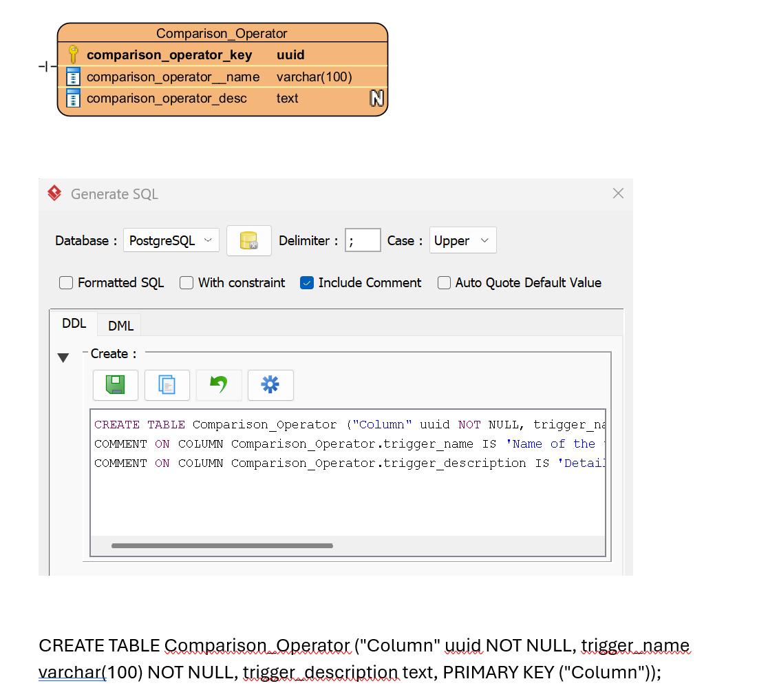

When I right click on the table and click Generate SQL, I get the old column names generated.
I closed and exited VP and restarted and loaded the same model. Nothing has changed.
I even tried Right Click on the table header and selected Move/Copy columns.
In the dialog I select one column to copy to the new table. It is copied fine.
Then I try to edit the name with F2 as above. The edit is fine but the Generatye SQL shows the column name pre-edit.

Update:
The diagram was set to Data Model: Logical. Thinking this might be the problem, I changed it to Physical, deleted the table I was working on, created a new table and still I was getting column name like this:
CREATE TABLE Comparison_Operator (
Column2 uuid NOT NULL,
“Column” varchar(100) NOT NULL,
Column3 int4 NOT NULL,
PRIMARY KEY (Column2));
even though on the ER diagram, they have the names I typed as above.

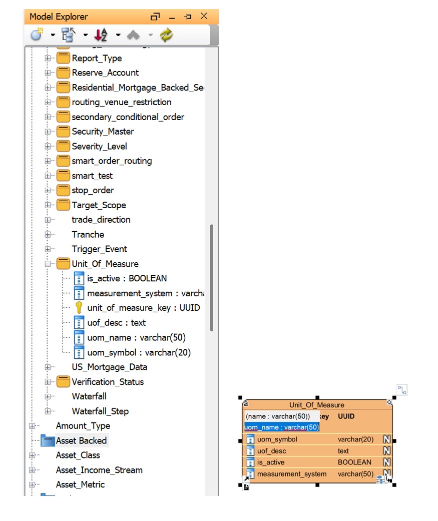

I think there is one more factor that comes into play here.
The table I am modifying was loaded into VP via DB reverse engineering - it was a DDL file, not a database.
The model explorer reflects the changed column names.
However, you can see from the diagram view, the original name pops up.

Thanks for replying. Having entities reverse from DDL actually make no differences. It just same as an entity directly create from diagram. But your latest screenshot to point out the cause of the problem you experiencing. It is just because your project do have nickname defined (Modeling > Nickname), while you are renaming the column on the nickname layer instead of the original name layer. Since DDL generation will only consider the info from original layer, this explains why you renamed the column (in nickname layer) but generated DDL having different column name (from original layer). For your case please make sure you switch to original name layer before make change to the copied columns.
Feel free to contact me for any questions.
OMG you found the cause. Thank you so much. I removed the nickname and now everything works as expected. I don’t know VP well enough yet to have found this. I am glad we have experts like you answering questions. Take care.
