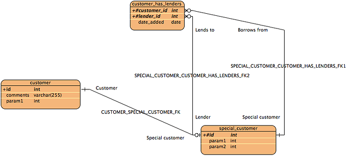

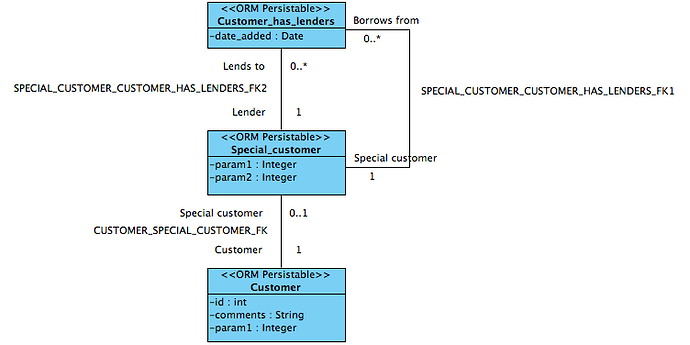

Could somebody help to find a problem in the following example (see attached ER + class diagrams):
The generated Java code with POJO + Smart association handling does not compile due to the following error:
