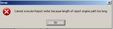

Hello Lilian,
There is a problem within the report writer.
If i want to try it, here is the error it occurs.
In advance thanks.
ps : I will come in a few with questions on the customization of word report.
Hi benoit,
Thanks for your reply. The Report Writer cannot execute if the path is too long. Please try to install BP-VA to a simple path (e.g. C:).
I’m sorry for any inconvenience caused. If you have any inquiries, please feel free to ask.
