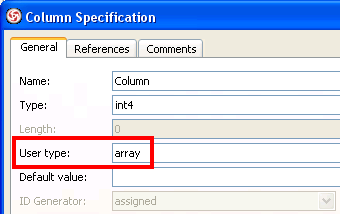

Hi user,
Thanks for your post. We are sorry that array for PostgreSQL is not supported, but you can enter it as user type of column (see attached image). In this way you will get the array type generated in DDL.
Hope this helps. If you have any further inquiry, please let me know.

Hi,
thanks for answer! Usertype as integer[] or int4[] works fine for me.
