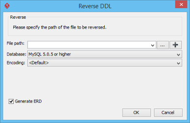

PS: If you have your DDL file, I suggest you reverse from your DDL

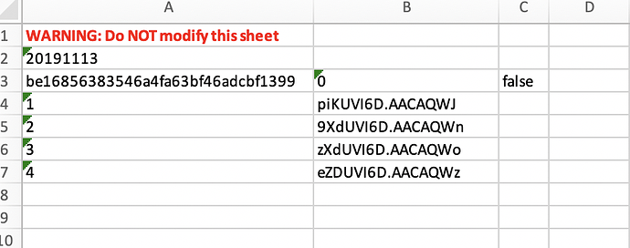

Thank you. I tried that method. But 1 problem still remains: How do I prepare the data in “System Data” tab ?
For the file you share, it looks like attached:
Please ignore the “System Data” tab.
It won’t affect your importing to create your entities into VP’s project.
fyi:
“System Data” is used to store the internal ID of the model elements.
And it is not expected to be modified in the excel file.
