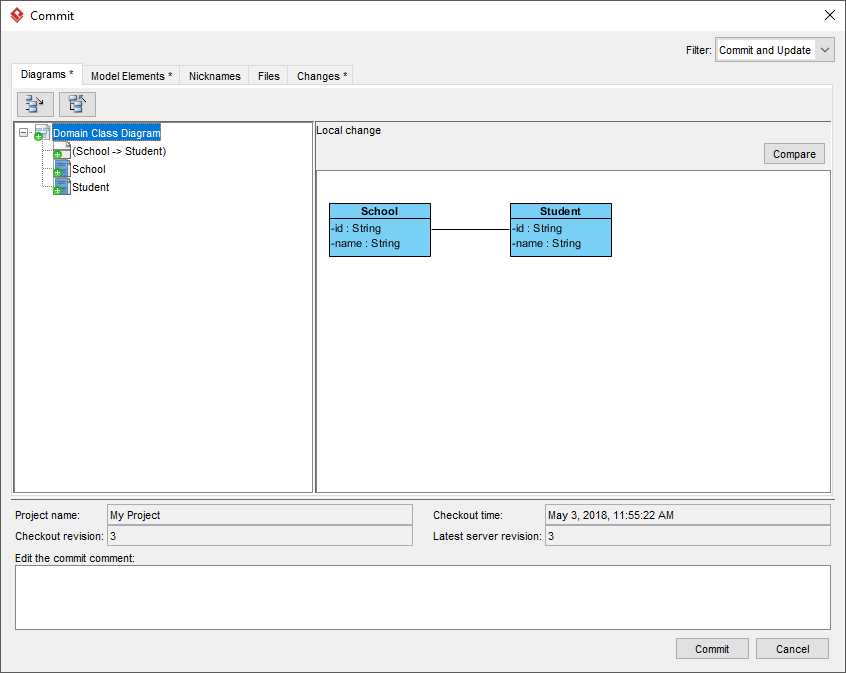

Thank you for your inquiry. To keep versions for your work, you need to manage your project in our VP Online repository. First of all, sign up a workspace by following the steps written in this article:
Once you have created an account, you can commit local changes to the repository. Each “commit” action will result in the creation of a revision. You can compare between revisions using the Visual History feature. The following articles provide you with more detail.
Commit changes
Using Visual History
