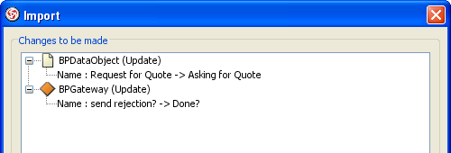

And I’m sorry for my late notification of VP Suite 3.4 release, which is available already. In this version we support export/import Excel for BPD, also we will show what will be updated during import (see image). Would this be sufficient to your requirement of Data Validation?
