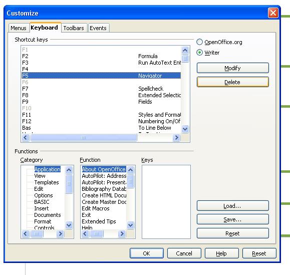

i don’t see the command (cf attached files)

Thanks for replying. Could you please run “VP Suite Update” inside VPSuite/bin folder to updating to VP-UML 7.0 SP1 and try to disable Tool > Customize > Keyboard tab in Report Writer?

i ve update the product, so now i can have the customize window.
i click on “delete” button for “F5 navigator” (cf attachment), so F5 is associated to nothing
But it don’t work, i ve now the log :
