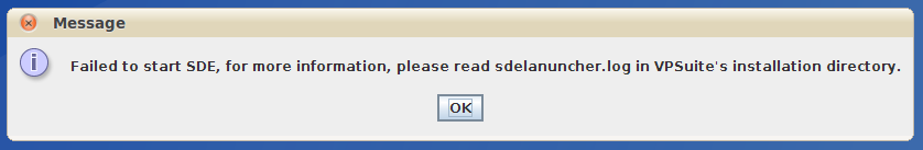

I had installed the Netbeans 6.9.1 and then install SDE for Netabeans 6.2.
i got the message “Failed to start SDE…” with promt to see the log file:
sdelanuncher.log:
[i]Failed to start SDE:
Working Directory: /home/ubunt10/.netbeans/6.9/bin
/home/ubunt10/.netbeans/6.9/bin/netbeans -J-Xms256m -J-Xmx768m -J-Dcom.vp.vpsde.nb.NBInit=tru[/i]e
My system configuration:
Product Version: NetBeans IDE 6.9.1 (Build 201011082200)
Java: 1.6.0_24; Java HotSpot™ Client VM 19.1-b02
System: Linux version 2.6.32-31-generic running on i386; UTF-8; el_GR (nb)

The first time i ran it was during installation process, when it finished. In the last window, it asked to start the service, i said yes but it did not started.
Also i tried it through the Applications menu → other → SDE_for_Netbeans_6.2.
I attached the error message.
