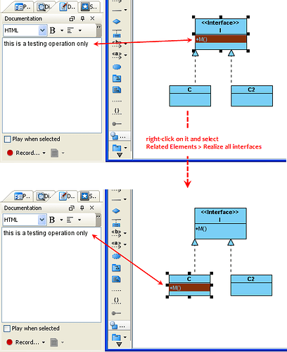

Currently we support realizing interfaces on a class (right-click on the class and select Related Elements > Realize all interfaces in popup menu), and it will realize the operations from Interface together with the documentation of the operations (you can refer to the attached image). Is this what you are looking for?
If this does not suit your need, would you mind to explain more about your requirement or provide some samples of your expectation? Thanks!

That’s perfectly what I need.
Thanks a lot.
