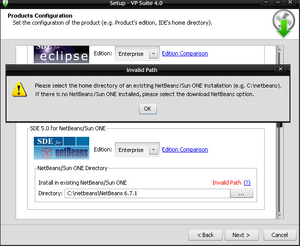

I can’t install SDE for NetBeans… I have perfectly installed the IDE on my PC. I don’t know why I cant install SDE.
That’s maybe a bug in the deploy softweare but there 's a work arround:
Move and rename your netbeans folder to c:\netbeans.
Don’t forgot change your netbeans icon for launching netbeans.
and restart your install SDE.
