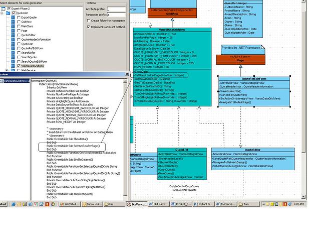

When I use Constant Generator function from the Menu to generate VB.NET code from Class diagram. They created codes according to the diagram but methods didn’t contain any formal parameters, although I added attibutes for the method during design diagram !

Procedure to reproduce :
I pick menu Tool > Constant Generator --> VB.NET
In the class selection dialog, I chosen all classes and click Generate.
Below is an example. (In the diagram, the method SetNumRowPerPage(RowNum : Integer) has a parameter is RowNum. But as you see below the code didn’t contain !)

I created the project in VP 5.3 that can’t generate parameters for methods and then I used VP 6.0 to open the Project. Result is : the problem is still there (There may be an affect in converting from old version to new version) !
Note: Although VP 6.0 generates the code smoothly with creating new project from menu but will fail if open VP5.3 Project.
