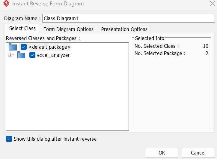

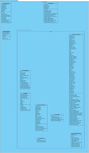

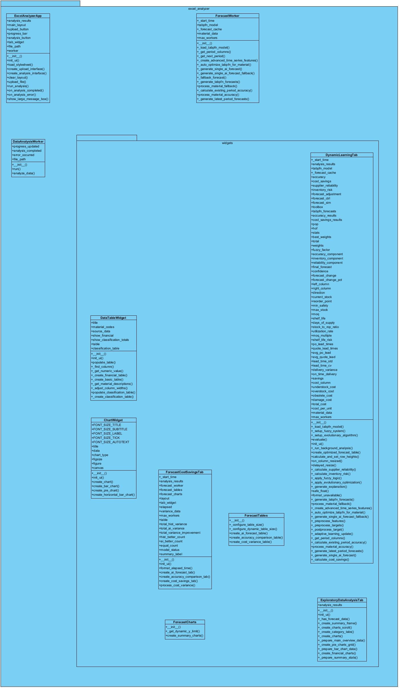

The UML class diagram generated does not show any relationships:

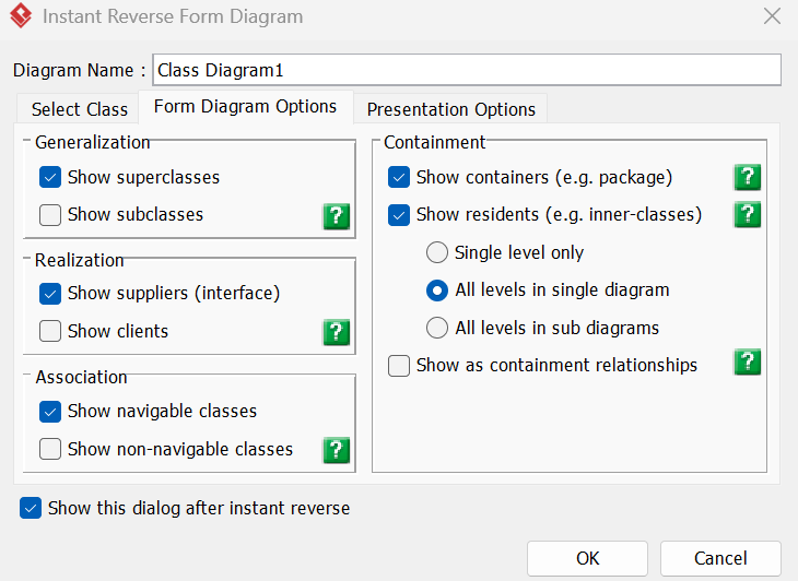

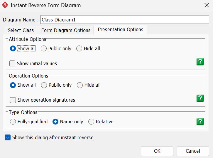

These are the settings:
Is this due to the way I coded in Python? I dont have any issues with Java or C++

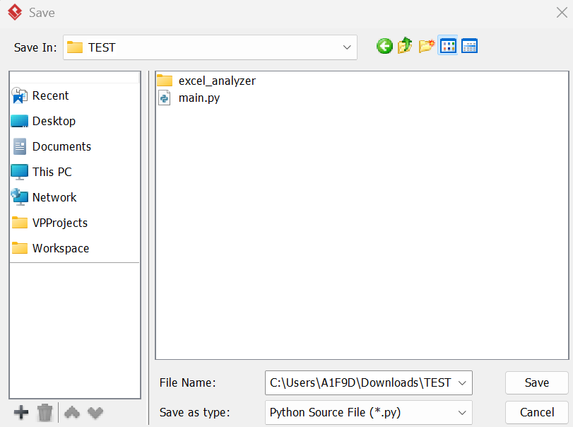

Edit: I realized another issue, my main.py and init.py (2 of them) are not being generated

Sorry for the delay. At the moment our Python Instant Reverse engine only support using type comment to perform type association and visualize UML association relationship. It not yet support the typing syntax in Python3. Since your sample source code do not have type comment defined therefore we are not able to reverse the types into associations. I’m sorry about our limitation on this. Feel free to contact me for any questions and wish you have a good day!
