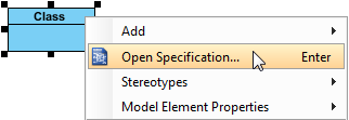

Mihály you are right, should define a stereotype for attribute with the deprecated boolean tagged value and apply to attributes. If define a standalone tagged value would mean the need to define for every attribute, except if we define a default tagged value, which would affect all attributes in the project.
Here is the documentation for using stereotype in Visual Paradigm:
https://www.visual-paradigm.com/support/documents/vpuserguide/1283/177_usingstereot.html
