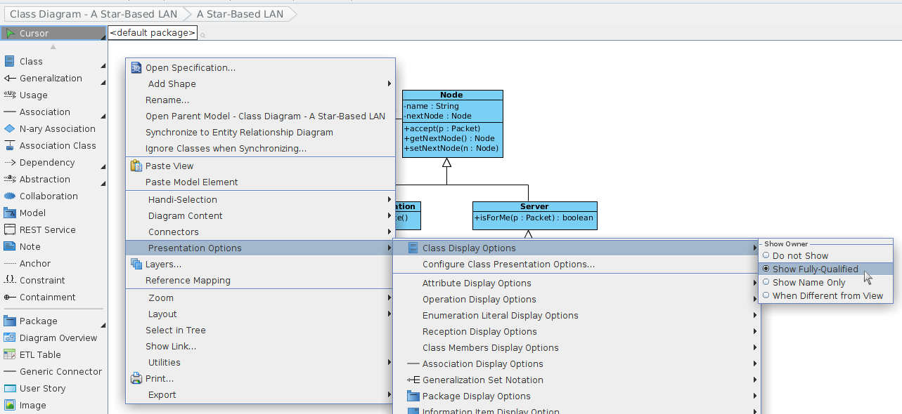

Hi Iris_Reinhartz-Berge,
For example you have below class diagram
In order to show full path of classes in class diagram.
- right-click on the class diagram
- set Class Display Options > Show Owner to Show Fully-Qualified
In order to move classes to different package.
- select class(es)
- drag and drop to the package
As a result, classes moved into different packages and able to show owner with fully-qualified.
Best Regards,
Roy.
