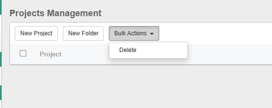

I’m trying to perform this action but I don’t have a “Import Project with Revisions”. It has “Bulk Actions” and only “Delete” as the action. How can I import a project?
May I know you are using on-premises Teamwork Server or VP Online as target for import the projects?
I figured it out. I had started with the local quick setup and wanted to move to the VP Online, and couldn’t find a way to do so. After spending a few hours trying different things, I deleted the Visual Paradigm directory, created a new one using a VP Online company account I had a co-worker create (I had created a VP Online account and it didn’t give me the opprotunity to specify the workspace name). and now I see the Import Project menu.
