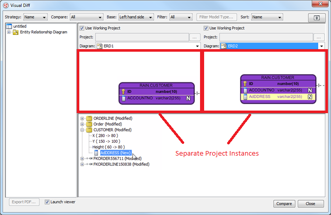

My algorithm currently compares one or multiple project’s Model Elements, Diagrams, and Diagram Elements. The end result is to provide helpful version tracking and analysis using Git as a version tracking tool.
My comparison algorithm fully works, but what I am trying to do is prevent as much user interaction as possible. It’s funny that you mention Visual Diff as a solution, because my algorithm currently imitates the Visual Diff functionality to an extent. I initially looked at Visual Diff as a solution but it was limited and I couldn’t expand upon the framework to fit my user’s personal needs. My goal is to expand and customize it to be somewhat automated. A Manual comparison wouldn’t work for what I’m trying to achieve. What I am curious about is the fact that Visual Diff can have multiple project instances within a modal dialog box. I would like to use a similar approach to extract info from multiple projects and present a user with a helpful GUI.
