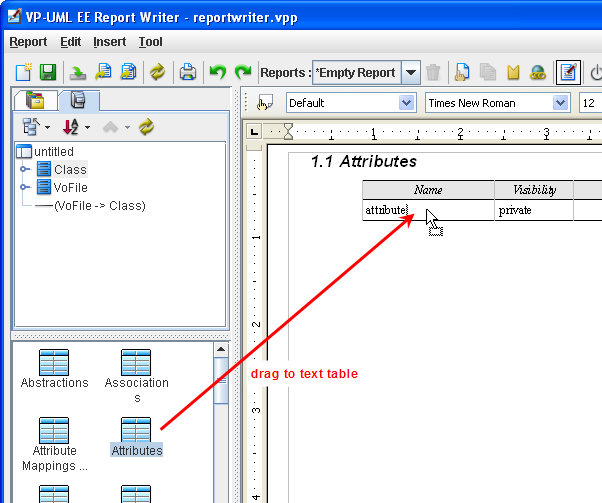

Cannot add any UML element template
May I know did you drag the template to the text table (see attached image) so getting the error message? If yes, this is normal. Maybe, if you don’t mind, you could tell me what do you want for doing this.
If this is not your case, could you tell me more details of how you get this error?
For the second point, i havec defined my own report tempate in Word (with images and guard pages of my document) bu the first drag’n drop i try to add any UMl element, i have my error message, as if all my document was a Text element…
Hope this could help to explain me what have i made wrong.
Arnaud.
PS : if you want i can sendyou the report template
Thanks for replying. For the problem of adding element template with error “Unable to create content block within a text section”, I tried import a Word document and then drag element templates to add to existing Word document. Unfortunately I cannot repeat your problem (except I drag the template to the text table, similar to my previous image), could you please send me a sample Word document and tell me detailed steps for repeating the problem? Thanks in advance!
