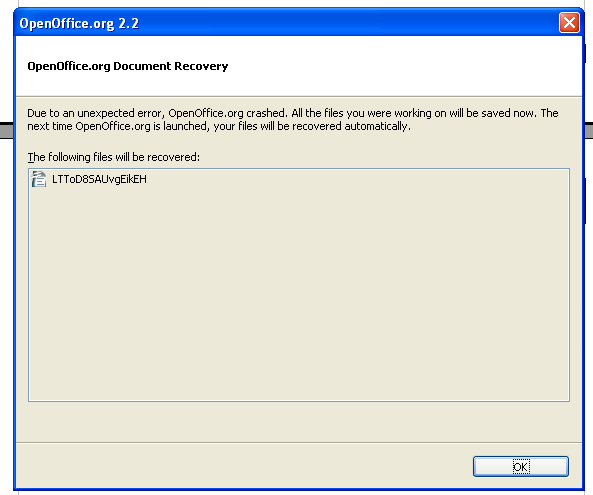

for now many days, i have crashes with Report Writer. Some document are no longer updatable from model (report writer freeze with a 50% CPU), and for the document i created this day it makes OpenOdffice crash.

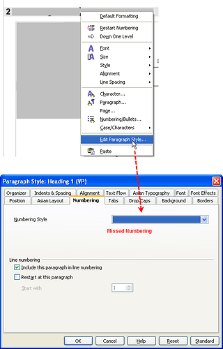

Our engineers checked your report and found the reason of crash - it cannot insert ParagraphBreak because Numbering of the “Heading 1 (VP)” is missing. I’m sorry that you need to re-generate the report contents to fix the problem.

Thanks for replying. Is all your existing report missed numbering (see attached image)? If so, could you please try to re-generate the report content and see if the refresh problem can be solved?

I created a new report this morning (just drag’n dropping element in it), but when i reopen-it i havent any numbering style in the paragraphe style for Heading 1 (VP).
I missed your message and I’m so sorry for my later response! You can select the Numbering style that suit to your content.
May I know you created a new report for the same project (the one has problematic numbering in report), or you created new report for another/new project?
