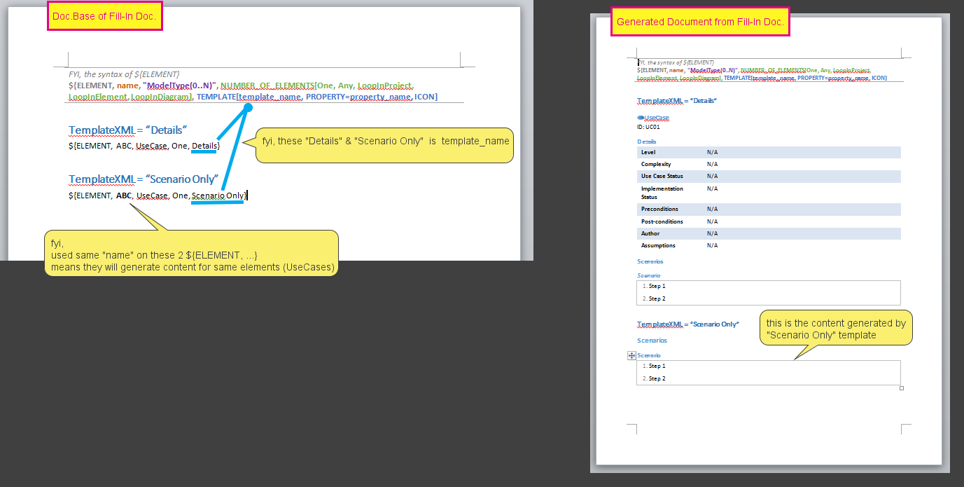

You can specify a customized template (e.g. duplicated from Details template) to generate the scenarios only.
Show you the syntax of ${ELEMENT, …}, and a simple result of a simple customized template.
If you need to customize the format for the scenarios content, the <FlowOfEvent> may not help you.
You may need to for-each the scenarios/steps and generate the TableBlock TableRow TableCell yourself.
You may reference to the following page, to know how to use the <FlowOfEventInterationBlock> to generate TableRow:
