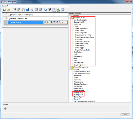

Hi, Is it possible to generate just the test case document(Procedure, Expected Result, Actual Result) from the use case detail functionality? Thanks JenRaj
Hi JenRaj,
Thanks for your post. You can define the report template to filter the details of use cases to fit your need. You can refer to attached image for which details of use cases you can filter in the report.
For details about report template designer, please visit:
Hope this helps. Please feel free to ask if you have any further inquiry.
