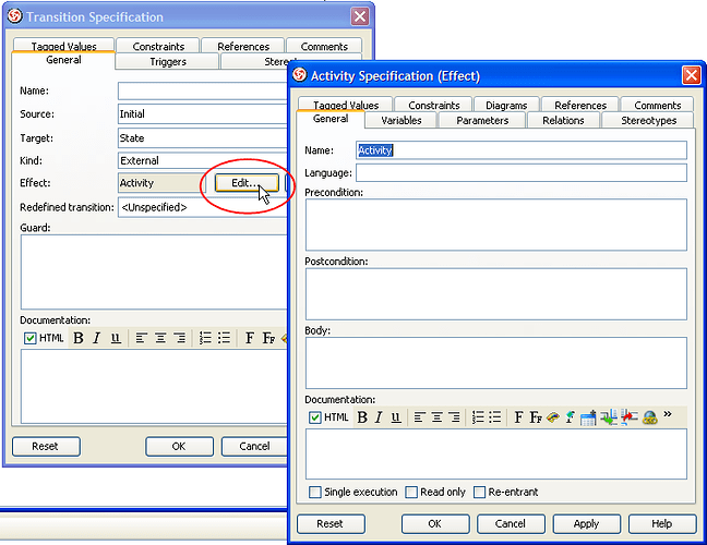

As far as I can see from UML 2.0 can a state transition have an activity.
In VP 6.1 (Build sp1_20071018) I can only add an activity to the states but not to the transition - as far as I can see.
Is this a missing feature or where can I find it?
Seems to do the job.
What I can create now is a transition labeled “event : / activity”.

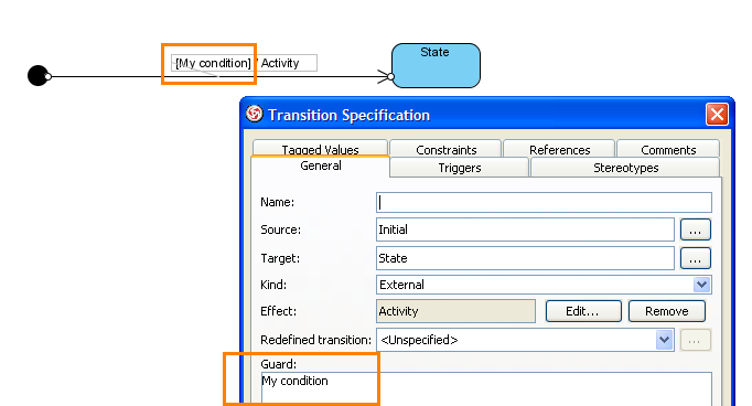

Fowler’s 3rd ed of “UML Distilled” shows in chapter 10 that the notation is supposed to be “event [condition] / activity”.
But I don’t want to nitpick, happy with the solution.

Hi Jochen,
You enter the condition to the Guard field in the Transition specification.
