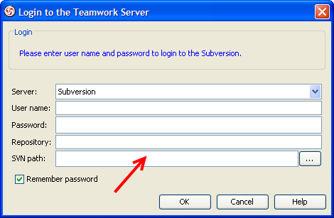

i don’t just know which svn path i have to enter in the dialog window…
Hi lagson,
Please enter “which svn” in console. The path printed on the screen is what you need to enter in the connection dialog box.

I have now another problem using svn+ssh on Linux…
When i now enter the correct svn path on my system, an error dialog is displayed with the message “login failed”.
On window i resolved this problem by creating an environment variable named “SVN_SSH” and gave as value the path to the file “TortoisePlink.exe”
do you have any idea to solve it on linux?
Thanks
HI lagson,
There are several possibilities that causes it failed to login. Could you show me your login dialog, and send me the log file for further studies? You can find the vp.log file inside $vp-suite-install-dir/bin
