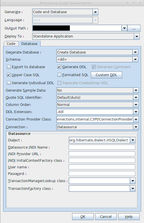

Do you support using Spring Integration to manage persistent manager instead of doing Persistent manager as Separate singleton, we wanted to use spring datasource to use it.

It’s 5.1.10
We support generating hibernate.cfg.xml with JDBC/datasource, but not support generating Spring configuration.
