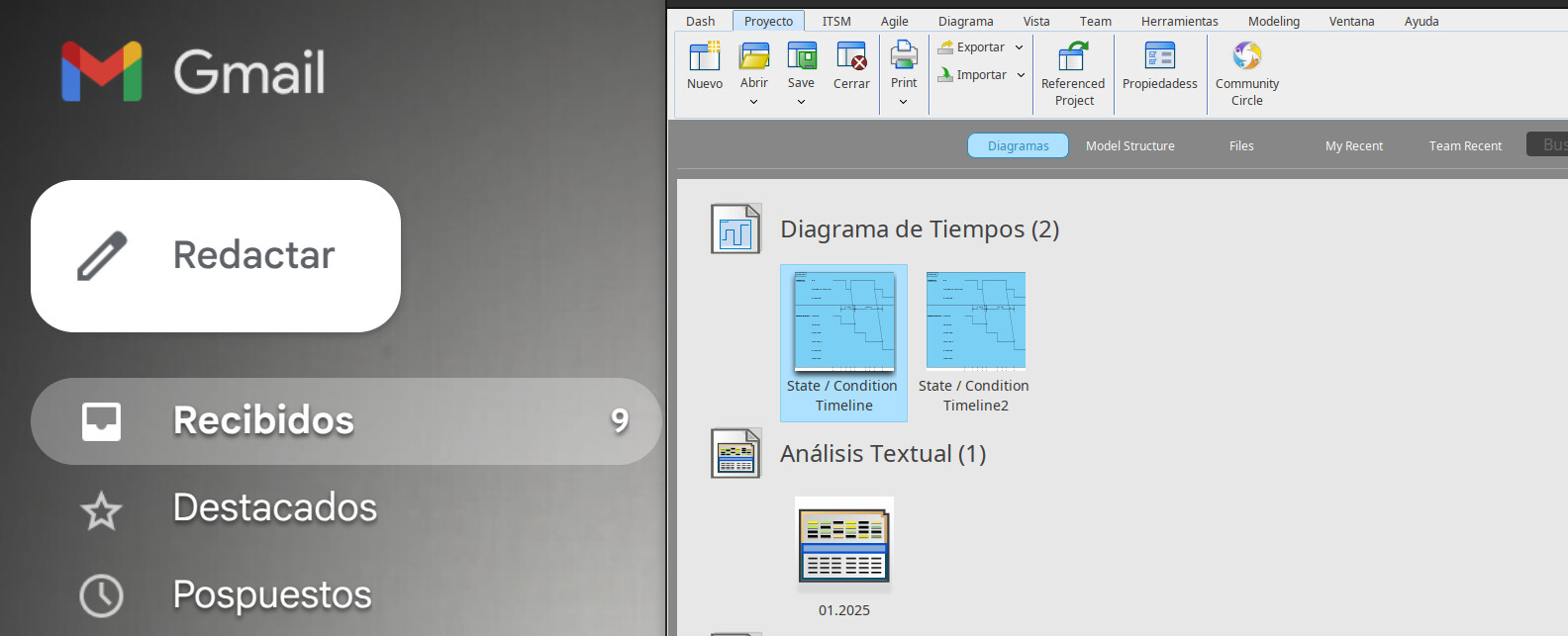

I have VP 17.2 installed on Ubuntu. It works but I can’t use it because the font size of the menus and system options won’t allow me to. How can I solve this problem?
I attach the image of the VP system next to the GMAIL screen on the same monitor

Hello Rain, thank you for your prompt attention.
I did the steps you showed me and everything came out perfect.
Thank you very much
