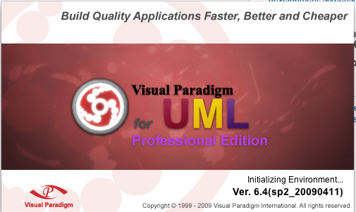

I upgraded to Snow Leopard yesterday, and since that I cannot start VP for UML version 6.4 sp2_20090411. I tried to update using VP Updater (I saw a thread here in this forum about the same problems with DBVA), but no updates are available. All I see when starting VP for UML is the start screen (see attached image).
Any help very much appreciated, thanks in advance!
Günther
