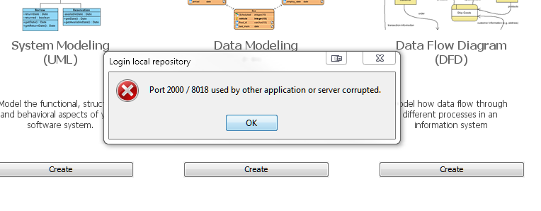

#7
Even i delete it, it still generates a new one during start up, Now i am trying to switch a workspace to see if i can start now, it gives me this error now
#8
Hi,
Are you running version 15.1? Did you update to latest build 20180931?
