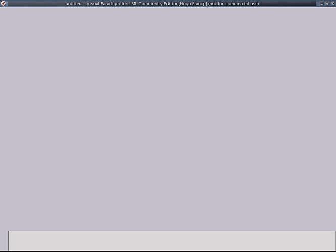

I just installed VP Community and I had no problems doing that but, when the VP starts, I only see a blank window and then, when I move the mouses pointer around the window, icons, menus and almost every thing else suddenly starts to appear. :shock:

Could you attach the $vp-suite-install-dir/bin/vp.log file to let us identify what the problem is? Besides, please post a screenshot to show this problem. Thank you.

Here I attach some screenshots and the log file…
