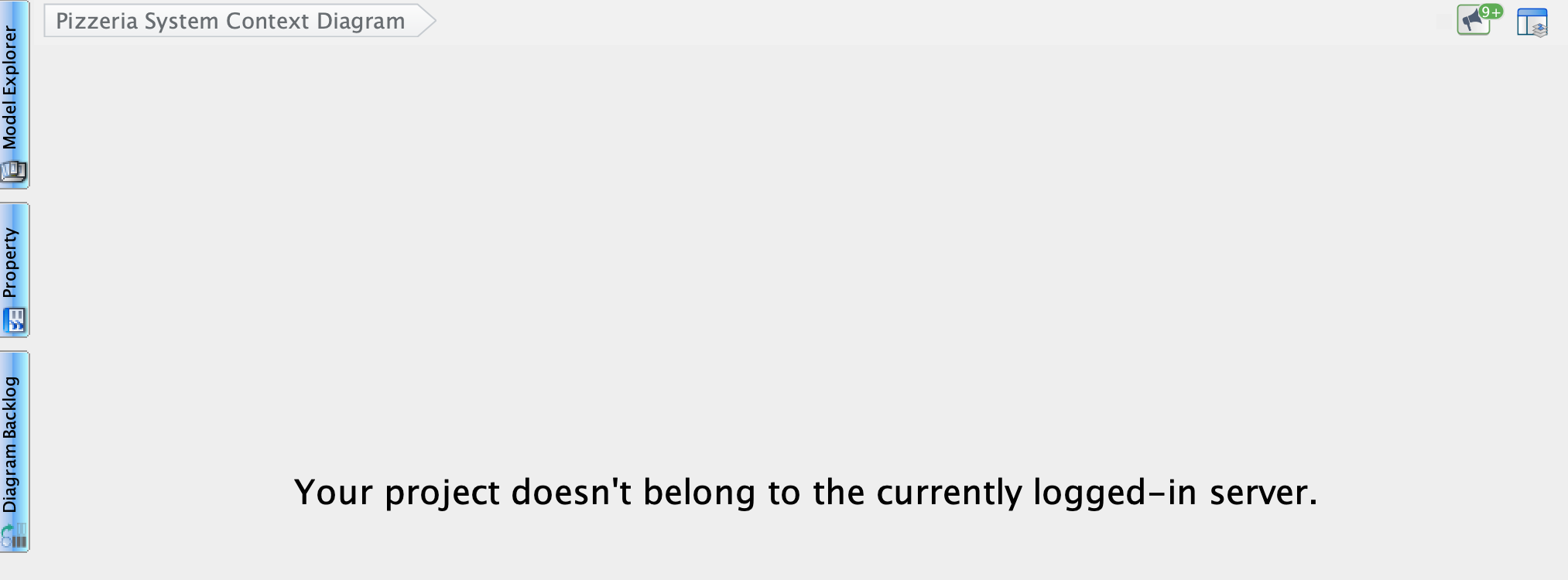

I had a battery issue that forced to shutdown my computer as I the desktop application was running. The opened project was an online project, but as I was without any network connection, it has been quite some time before any sync.
Unfortunately, I am unable to get back my work : the online version is not up-to-date (which is normal), an I have a frustrating issue with the local save.
I cannot recover or load it : the thumbnail when I select the project shows the project as it was last saved, but trying to open it leads to this message : Your project doesn’t belong to the currently logged-in server
The diagram appears in the diagram navigator, but I cannot access it.
Is there a way for me to get my work back? What does this error message means?
Thank you four your post. It looks like you are opening a different local workspace folder that stores the connection information of another online workspace. Please following the article below to switch to the correct workspace folder, or a new workspace folder and checkout your work again.
