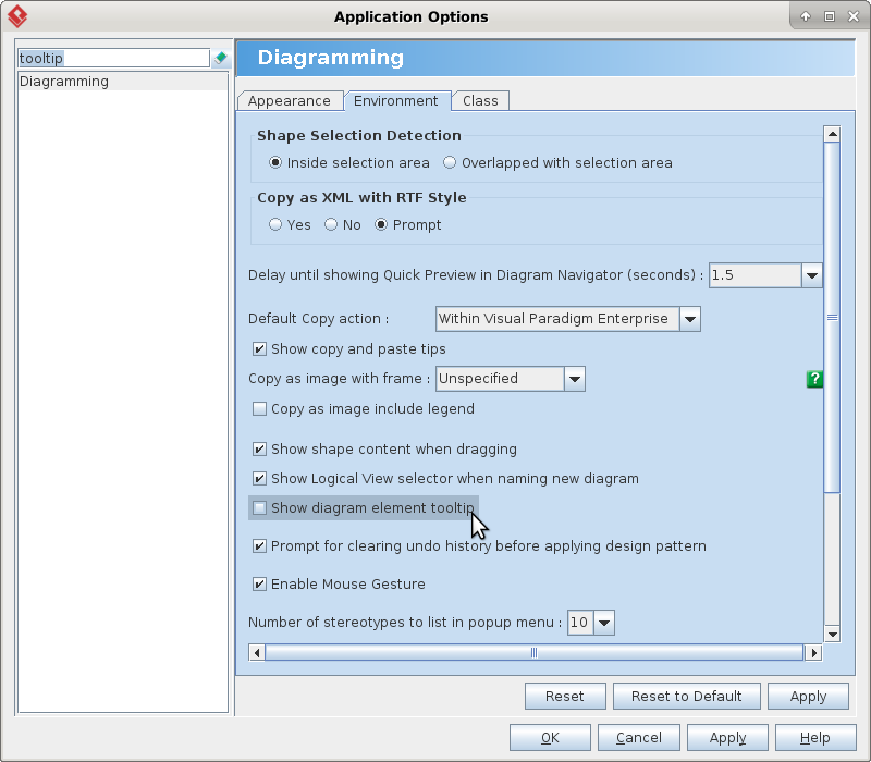

I’m sure there is going to be a trivial solution to this buried in the options but I haven’t been able to find it.
I use extensive notes throughout my modelling. When editing them, the major irritant is that VP insists on previewing the content (why? It’s there in front of me!!) which, with a large note essentially entails a “tooltip” type preview which completely blocks that note I’m working on and makes it extremely awkward to edit.
How do we switch that behaviour off? and I mean permanently, throughout the model, not just ad hoc for a particular object or drawing. I genuinely haven’t encountered a single occasion when that preview has been anything but annoying.

although I’m interested in your opinion, it isn’t really relevant to my question. There is no need to get into the pros and cons of previews. As I conceded in my previous, other users might find them useful (and unobtrusive). Good for them. I don’t. My question is simply: “Can I turn the previews off, and, if so, how?”
I knew (if it existed) it would be simple. Very well buried though. For anyone wishing to follow in my footsteps the exact (menu) path to the option is:
\Tools\Application Options\Diagramming\Environment(tab)
That’ll get you to the page Antony displays above.
