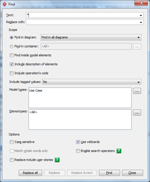

I am trying to find all model elements of a given type that have a comment. Is there a way to do this? I am using VP Professional edition.
I hardly use the search options myself so I could be overlooking something, but I don’t think the search feature provides a way to specifically search for a comment to be present. The main problem is that the search feature doesn’t only check the comment section but does so besides checking for the model element names:
