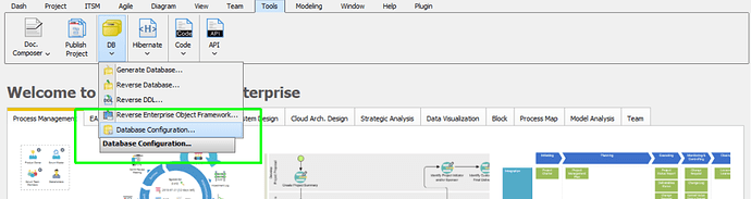

Now, I quickly peeked at the Hive website and I noticed that they provide a JDBC driver. This means that, theoretically, you should be able to import that driver into Visual Paradigm. Note that I don’t have hands on experience with this myself, but:
You can find this dialog by opening the Tools pane and then opening the DB menu and selecting ‘database configuration’:
Hope this can help!
