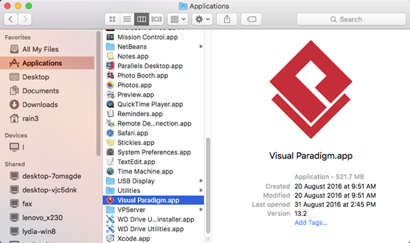

Hi racemus,
Could you try to star Visual Paradigm by running:
Application\scriptsVisualParadigm.sh
Please let me know if it works.
Best regards,
Jick Yeung
I’ve tried already. It asked me to install JDK, but it won’t start with JDK too. It just stuck with loading window.
I ran this script
/Applications/Visual Paradigm.app/Contents/Resources/app/scripts/VisualParadigm.sh
